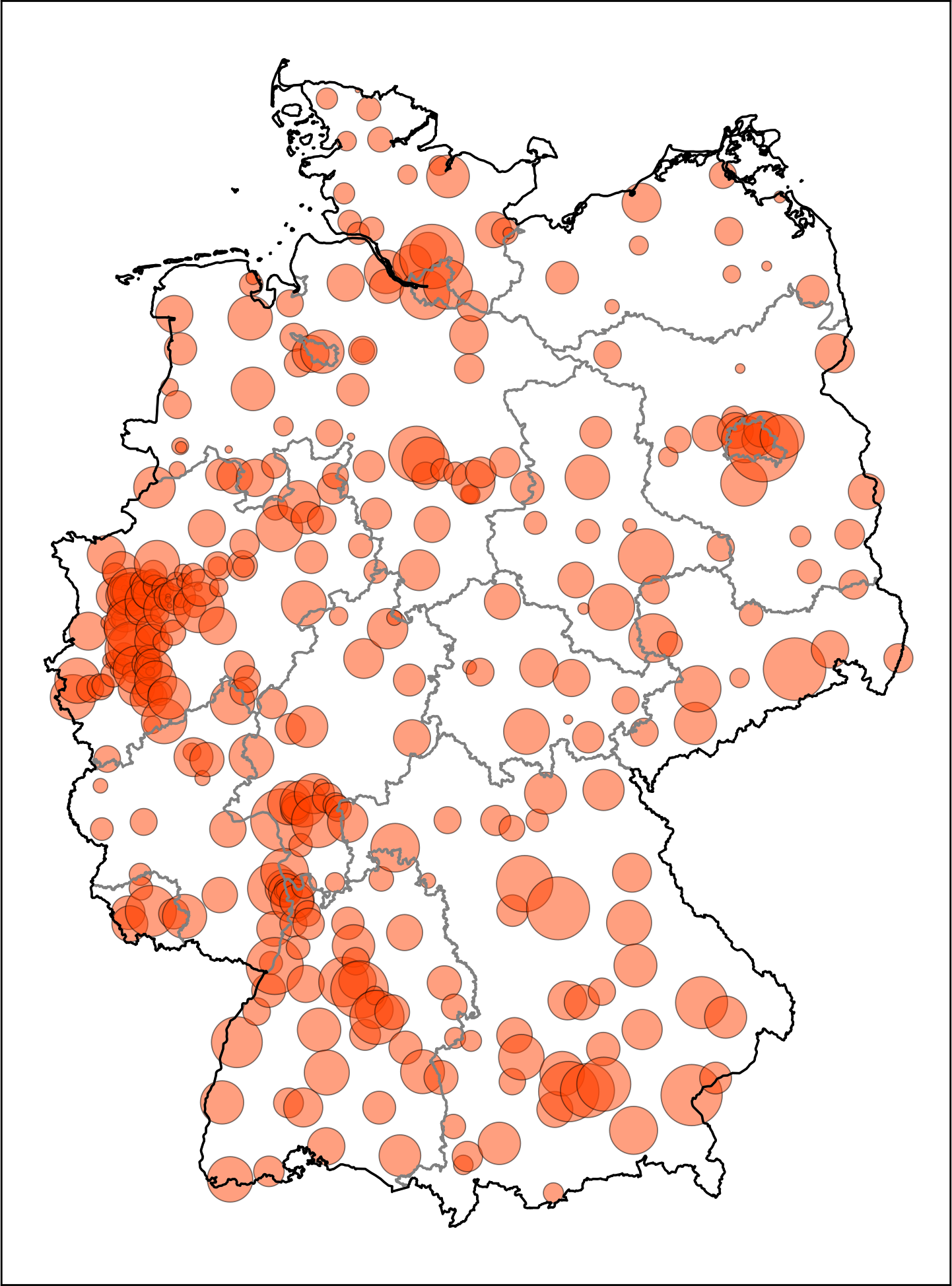

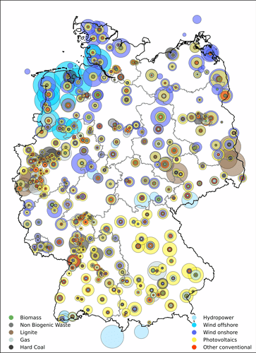

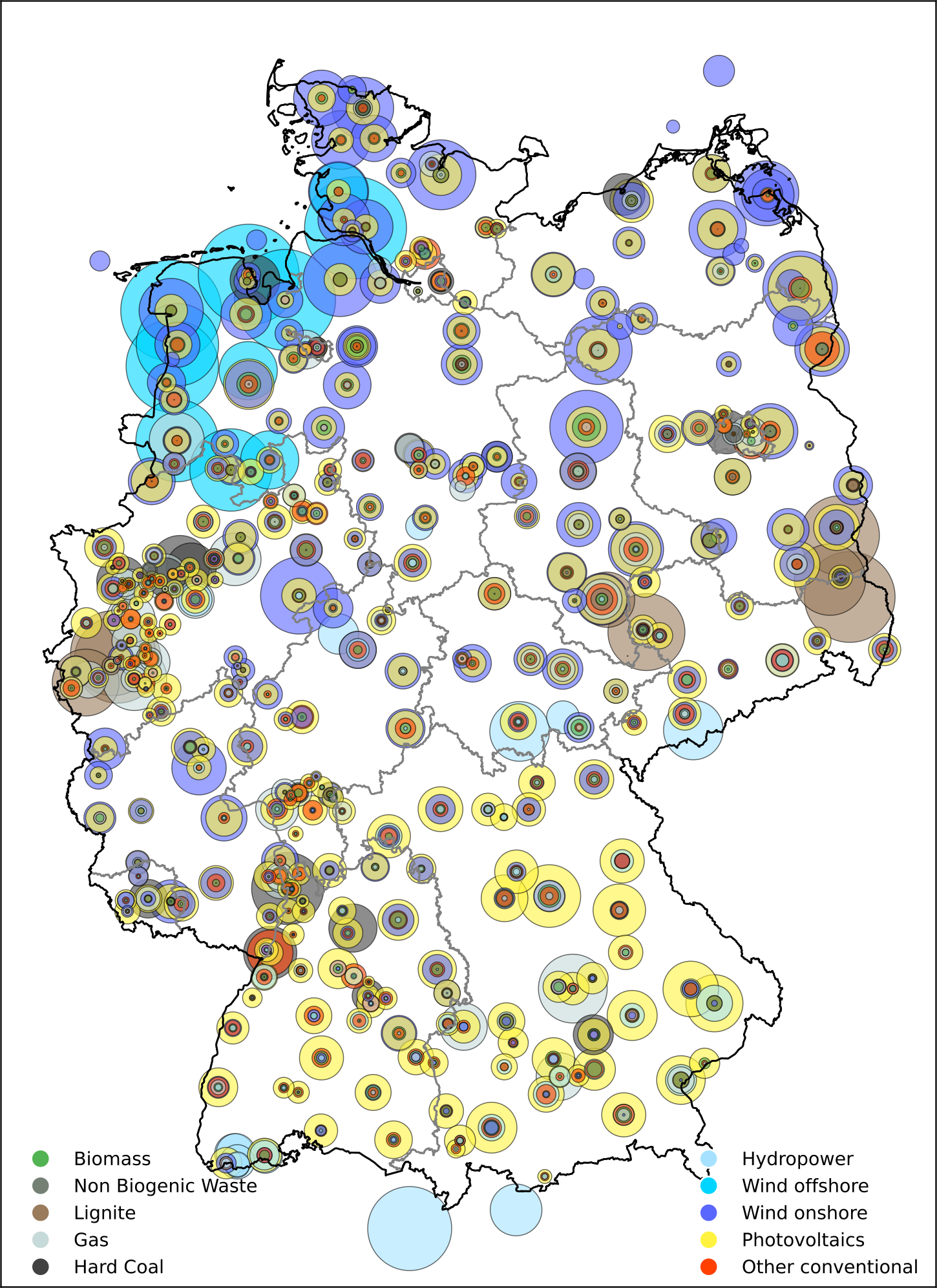

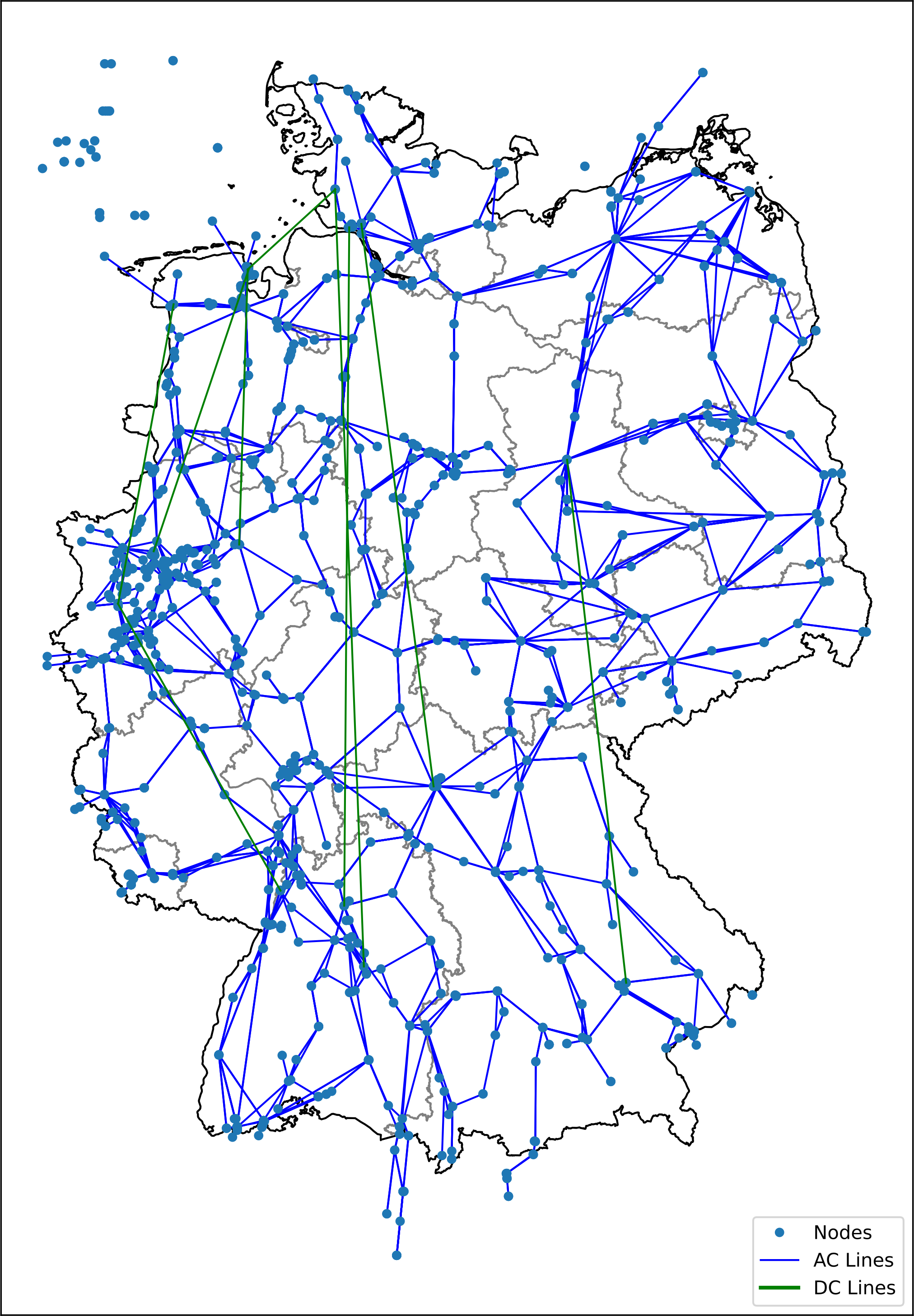

Six months after my initial post, I’m happy to report that I’ve completed my Master’s thesis and developed a working prototype for importing ENTSO-E’s Bidding Zone Review (BZR) data into PyPSA. The main challenge was the BZR dataset’s inconsistent use of the CIM/CGMES standard, which required custom import code—little things like they represent DC Lines as AC Lines. The final implementation was more of an “academic research prototype” than the elegant solution I initially envisioned. While I can’t share the whole network due to NDA restrictions, I can share the visualisation of the grid. Attached is the topology, load, and generation of the BZR model.
