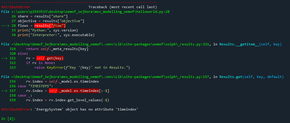

that I receive a error message for extracting the flows, as the datetimeindex got deleted. See attachment. If I though print energy_system.timeindex, I get a normal DatetimeIndex.

Hi @karombo,
The dump/restore workflow has some known issues, in particular when there are version differences (any dependency) between the dumping and opening session. The same might be true if you use different operating systems. Dump really just dumps the memory image. In fact, we are planning to replace “dump” in a future release.
If you have a solved energy system and just need the results anyway, I’d suggest to rather export the specific results than dumping the energy system. If you have problems dumping/restoring in the same environment on the same machine, however, that’s clearly a bug. In that case, I’d look deeper into the issue.
